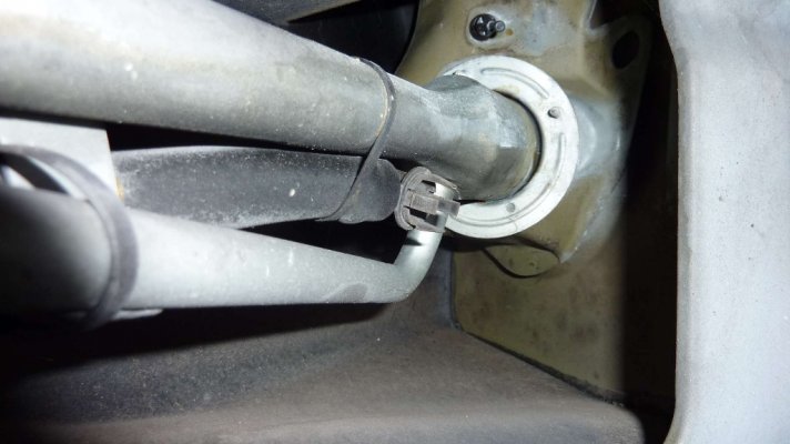

I tested EGR with vacuum test and vehicle died immediately.
The purge valve looks recent and has a date label of 2020
The area around the canister mount and vent solenoid is filthy/sooty. I have a new solenoid arriving and will check/clean that area and canisters further on replacement
The filler neck has corrosion throughout and is loose. A replacement is coming.
I think I am on track, but one outstanding question I have:
There is a vent line coming from the canister area up along the filler neck and hangs behind the filler panel. It has a green plastic connector that looks like it wants to attach to something, but I don't see anything to receive it.
Is that supposed to connect to something, did it leave the3 factory like that or did someone take a shortcut and leave it open to the atmosphere?
