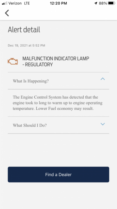

Whenever the weather gets colder I get this code that says my engine is not heating up fully. The temp gauge also stays below mid line and when accelerating drops to almost 1/4 of the gauge. I have tried a coolant flush, checked coolant levels, and replaced the thermostat twice. Any other suggestions for troubleshooting?

That's usually from a stuck open thermostat but do you know what type and / or temp thermostat was installed or have a picture of the last one removed? Only other thing that helps warm up the engine are the radiator shutters but that just assists and really the T stat does almost all the regulation. Maybe the shutters are stuck open? Take a look through the front grills with the climate control system off while the truck is cold started and idling and see if they are closed. There usually open when the car is turned off then adjust to what's needed as you start then drive.

Owned it new, or bought used? Wondering if the Thermostat was replaced with a lower temp one. Common in the Tuner crowd.

Did you use the correct OEM Motorcraft thermostat, or aftermarket?

Could be a coolant temp sensor as well. Unlikely to be a thermostat if all 3 are giving same readings (original and
2 replacements)
I bought it used and replaced the thermostat twice with OEM factory part purchased from the dealership.
