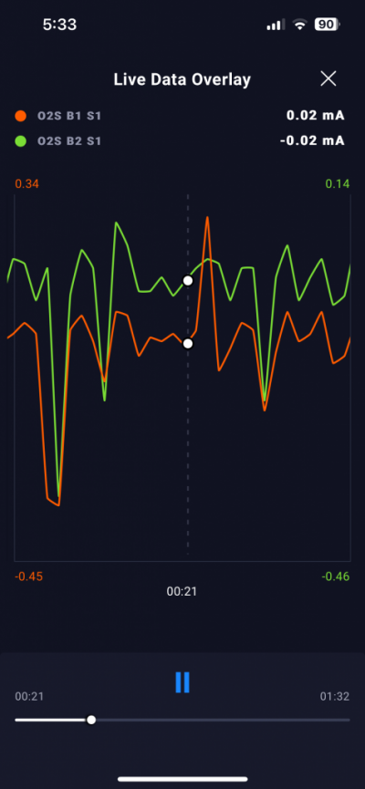

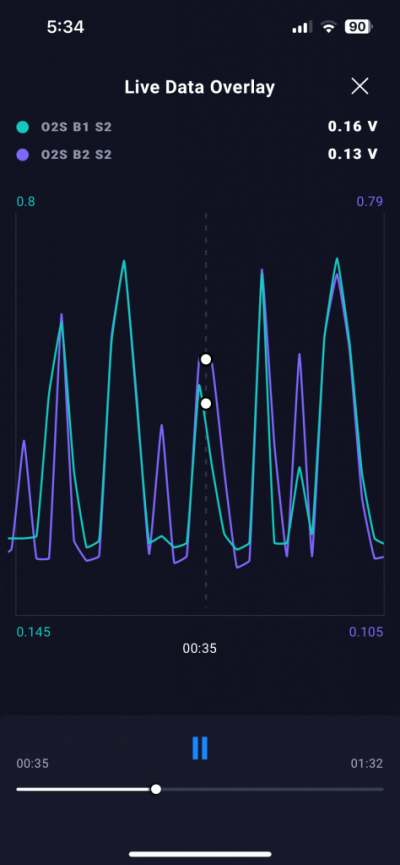

More info below. My scanner indicates there are issues with sensor 1 on both banks, but the live data shows them both operating what I think is normally. Any thoughts?

Sensors seem to be doing their job of reading and reporting.. I'm not sure what your pics are showing but most likely it's some upstream causing the o2 sensor to read bad oit put therefore they try to adjust and throw a code when out of limits.could be vacuum leak or bad info from maf sensor. Voltage to o2 is sent from pcm but could be bad ground or corrosion at connector.
Please reply with what you find. Don't throw parts and $$ at it. You can give the money to me instead. Test first
