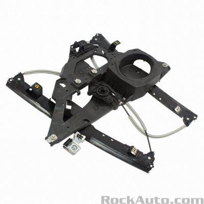

When it comes to window regulators, I've always had the best luck and service from factory OEM parts. What kind of warranty company is this ? The price difference is only about $20 at the shop rates. See if the shop doing the work will allow you to buy your own OEM parts and they just install them. Particularly on the driver's window, that sees frequent use. A new regulator always comes with new cables.

Sounds like you have some aftermarket warranty from a private provider. You shouldn't have to pay to replace a defective part. On another hand, I would only use a Motorcraft OEM regulator. It seems that Chinese replacement window regulators are often of very poor quality. They are cheap - very cheap, but while some will carry on well others simply fail quickly.

For those who like meddling with these things, the window regulator on these trucks is a completely self-contained unit with a bolt-on motor. The unit has pulleys and cords that control the window. When they slow down, the regulator is gummed up and the tracks get dirty. Usually the entire thing can be removed, gone over and reinstalled to improve the operation.
Unless you use a quality part, you may be better off cleaning, degumming and lubricating the Ford regulator and cleaning the tracks rather than replacing the part with an Amazon Red Dragon cheap part which can possibly be garbage out of the box.
