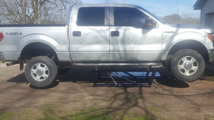

Here's a photo from their site of an F150 on the lift.
https://www.quickjack.com/car-lifts/bl-7000ext/
