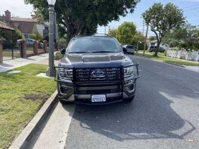

Hello,
I just installed the Ranch Hand Grille guard and it is triggering the center parking sensors. According to Ranch Hand's website, this is not supposed to happen. Have any of you installed this guard on your truck?Did you run into the same issues? Just want to make sure I installed correctly before I call/email Ranch Hand.
My truck is a 2020 Max Limited FX4 and this is the girlle guard:
https://www.ranchhand.com/ggf19hbl1c-2018-2019-fordexpedition-legendgrilleguard-camera.html
Thanks in advance

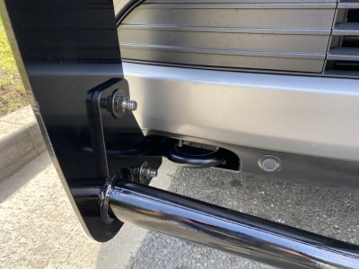

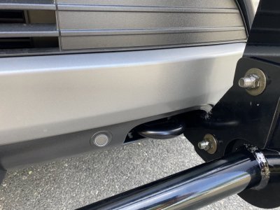

Ummm....the bar looks like it is basically right in front of the sensors so how would it not trigger them???

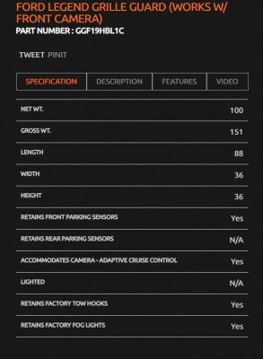

This are the specs on the site; only reason I bought the grille was because they claim all sensors work; I'll call the company om Monday.

Says retains, not works with or accommodates or they are still useful. You may have fallen for a technicality (also read as sneaky working).

Call them and complain. Might have to forscan and disable it....if its even possible.
Mommas car
Mar 15, 2018
Oregon
I installed that same grille guard on my 15 Expedition. The is a little play in the mounting before you tighten everything down. What would happen if you rocked it back a bit? It looks like you have a little wiggle room.
