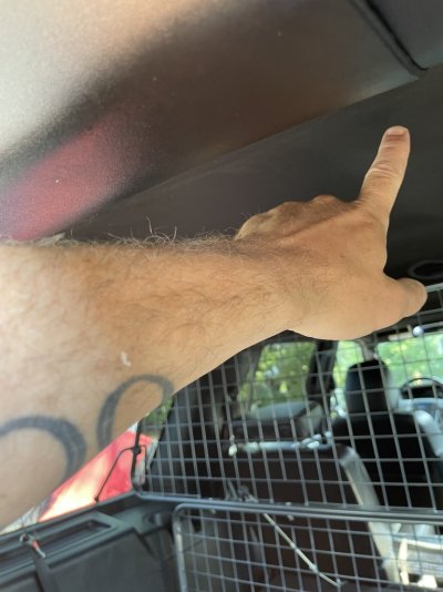

I attached a photo showing about where the hard line connector is located. The tube from the engine runs up through and ends in a hard tube. Your rubber tube going to the rear washer blew off there. It’s tight but you can reach between the headliner and roof and get it on there.
