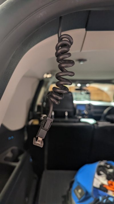

So this fun story gets even better. Walked out to my garage yesterday to notice this dangling in the rear view mirror.
Just got back from dealer, have an appointment next week for a new lift glass. And at the same time. I was actually able to demonstrate the wiper issue to the service manager. They are ordering parts for a new wiper motor as well. But they told me could take two days to do the glass and wiper motor? Really, seems like 3-4 hrs to me. Also. They have 33 people in line for loaners, so looks like I won't even get a loaner vehicle. What a pain, and also, what ****** designs. Every vehicle I've owned in the last almost 20yrs had a lift glass, not one of them had ever had a wire yank off and I used to be that guy driving around with the lift glass open and bouncing around (usually cuz I had lumber sticking out the back)
