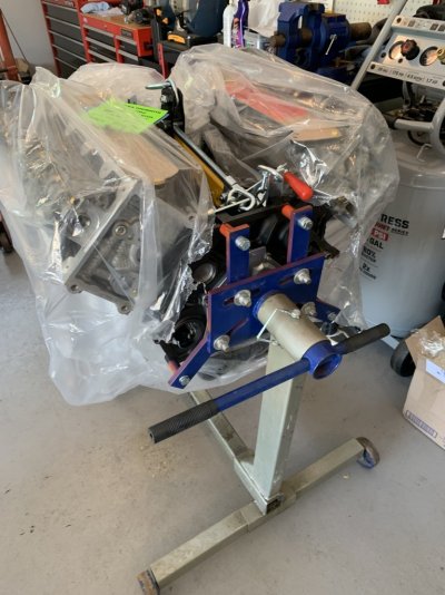

I’m installing a reman’d 5.4 2v in my 2003 EB. I’ll capture the process in this thread for those that may be interested. I went with an AER engine retailed through Power Source. AER remanufactures engines for Ford dealers, so I figured it was a solid choice.

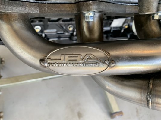

Quick question: I’ll be going back together with JBA shorty headers model 1679-S, and I’d like to install the headers while it’s on the stand before dropping the engine back in. Should I expect any fitment issues? I’d hate to have to do the headers after the fact. If anyone has any ideas or experience with those headers, it would be greatly appreciated!

If you don't get much response on this forum regarding the headers, you might try some of the Facebook pages for Expeditions and F150s. Seems to be more interest about modifications like that on these pages. I have seen posts on one of these from a guy saying he has done alot of 5.4 swaps and always does them with the exh manifolds still attached, for what that is worth. Try these if you are interested:

Thanks for the input Vince, and fair point. For the most part, the JBA headers will be the only significant mod to the otherwise stock 5.4 swap.

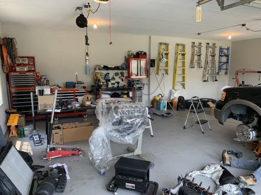

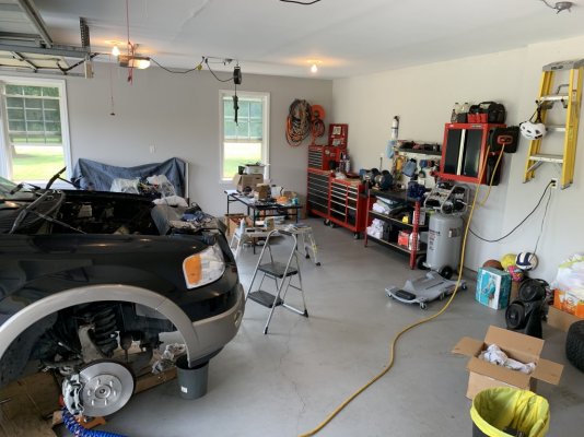

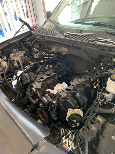

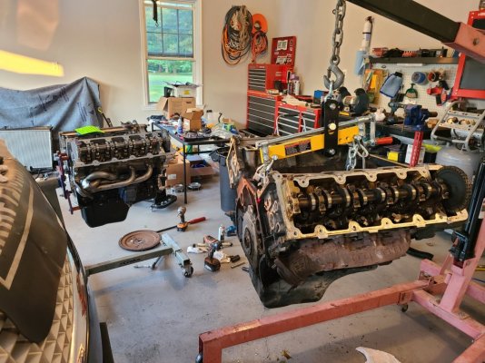

After spending a few days with the engine swap, got it out at least. Ran into the typical issues pulling out a 20 year old engine. Broken fasteners, stripped exhaust manifold-to-exhaust nut, and more deteriorated parts, hoses identified once the engine was out. I’m trying to go back together with all Motorcraft parts, as they seem the most reliable bet with all of the other cheap junk on the market. Most proving to be long-lead items, but can be found. By no means is this a tutorial, but here are a few pics for your viewing pleasure. IMG_4474.jpeg

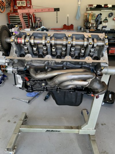

Got all the items moved over from the old engine to the re-man’d long block. Should have it wrapped up in the next week or so. Really looking forward to 1) no oil leaks, and 2) a truck that’s reliable and starts every time I turn the key. The bitter-sweet part of this deal is once this project is complete, off to the airport she goes; hence Airport Car II.
