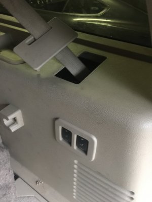

I have a 2015 limited LT with the right 3rd row seat belt badly damaged. The webbing has been badly torn but the retractor is fine. Does anyone have a guide or advice how I remove the plastics panels and then remove the belt and retractor so that they can be replaced? Thanks.

Pop off the trim piece with vinyl prybar
Unscrew the seatbelt, I think you need a torn T50 or a T55 maybe
Replace with a junkyard belt, maybe $20 if that
If the retractor on that is jammed in full retraction, pry up the white plastic side, retract some, clamp it with a clamp or hemostat to keep it from rolling back up, replace thr plastic piece and mount it in truck. Once it is in proper position the retractor should free it.
Thanks for the advise.
I pulled off the trim piece and can see the retractor down the hole, but I am not sure the retractor will fit through this hole and it looks almost impossible to reach the screws that hold it place. Here's a couple of photos of the trim piece off and a view down the hole showing how difficult access to the retractor is.
Before I tackle this, I just want to check that this is what you meant.

Side panel needs to come off too
Yup, the whole thing

OK. Thanks. Any advice or guides on how to remove these panels?
