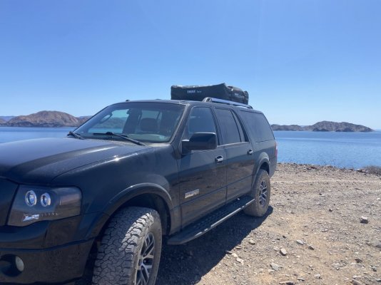

The Rator has 3 bracket points front and back that line up perfectly. The middle one not so much. 2 bracket points works great.
You can do the extra work and install the middle bracket you just need to drill and install the right size threaded rivet fitting and you are golden.
