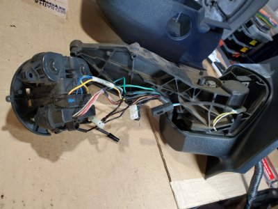

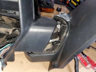

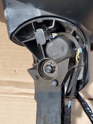

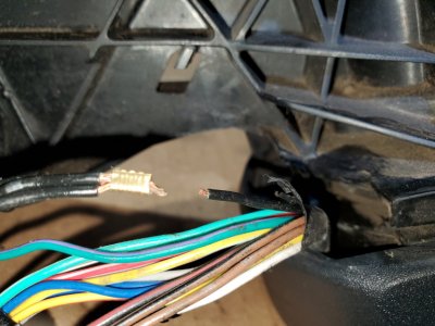

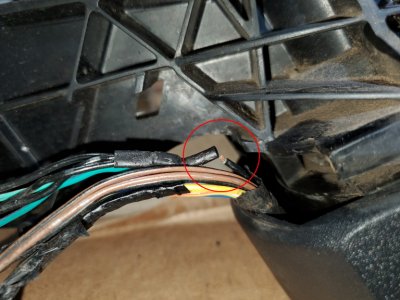

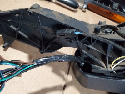

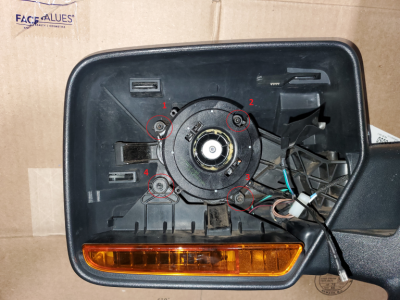

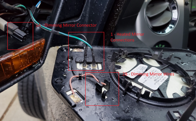

I appreciate the guidance and responses. Between the weather and work hours I didn't have a chance to revisit this until today, and it was raining steadily. After removing the driver's side mirror I encountered the following.
1 - detached the heated mirror connections, activated the rear defroster, and checked voltage on the GN-VT and BK wires indicated below. The reading was 3v, which is likely the cause of failure. I couldn't check the RH mirror for reference at the time but I would expect 12v since it's working correctly. I expected either 12v or 0v, so pondering causes of the low reading.

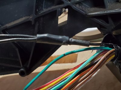

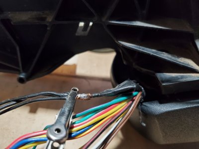

2A & 2B - The auto dimming wires were broken at the connector. This is puzzling since the connection was severed at the very end of the pins, seemingly just below the surface of the connector. It doesn't seem logical that someone would cut these wires rather than simply unplugging the connector if there was an issue with this circuit. I removed the pins from the connector, recrimped and soldered the wires, and restored the connector.​
I will have to trace the heated mirror wire to locate the failure, weather permitting. There is continuity at the connection points on the back of the mirror.
Any suggestions on reliably triggering the auto-dimming circuit and the voltage reading I should expect on the that line? The marking just below the brown connector indicates '1.4V MAX' but would like to verify considering my unfamiliarity with this circuit.

Just a quick update. I tested the dimming circuit by shining variable light at the rear view mirror sensor while checking voltage on the white supply connector (exhibit 2A above). The voltage reading ranged from 0v-1.35v based on the light intensity, which falls below the 1.4v MAX indicated on the back of the mirror.
I also retested the heated mirror supply wires and got 12v (13.4v exactly but 12v will be referenced as proper voltage in this case). I manipulated the wires while testing to check for intermittent connection but voltage remained constant. I am perplexed about yesterday's 3v reading.
Snapping that glass back in place was a bit of a challenge. I positioned the lower clips first with the intention of securing the top clips last since the mirror tilts downward to provide some visibility and access but it took 3 attempts to finally get it in place. It felt secure at times but the visual inspection revealed that the top clips were not properly secured, so be diligent if you run into this.
A short test drive confirmed that the dimming is now working, but no joy with the heated mirrors. I once again removed the glass and confirmed 12v on the heated mirror circuit with the rear defroster activated. I also tested 10.5 ohms resistance between the heated mirror leads on the back of the mirror and successfully used a 12v power supply to verify functionality. The connection remains the logical culprit so I'll clean the female spade connectors with electrical contact cleaner and sand the leads next. It's still raining here and snow is expected tomorrow so timing is uncertain.

I know how much work it is taking mirrors apart. Not fun!
I was thinking you might have a broken trace in the heating element, causing an open circuit. But it looks like you verified continuity so it seems your element is good. You might use an ammeter connected in series though to make sure it's drawing current.
When I had my Grand Marquis mirrors apart I noticed the heating element is just a foil layer on the back side of the glass. The connections were very tight but the metal tabs connecting the electrical plug to the foil trace weren't secured that strongly. Just unplugging the connector caused a great deal of strain and I could see the tabs trying to lift off the glass. It looked like they could be damaged quite easily.
