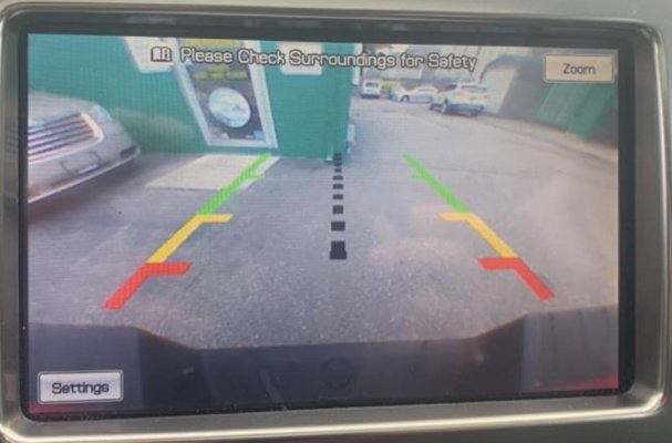

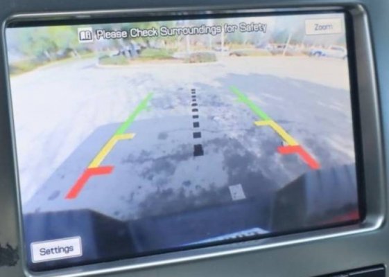

Looking to photos of 2022 Expeditions offered for sale online, and being mindful of possible quality variations in the photographs...
2022 XLT With 12" Screen and Analog Camera
2022 Timberline High Package 501A With 15.5" Screen and HD-Quality (My Description) Camera
2022 Expedition Timberline w Optional 15'' Touchscreen with Digital Camera Image.jpg
I expect both camera images look better in the vehicles than they look in these photos.
It strikes me as comparable to watching television on a Cathode Ray Tube (CRT) model (yeah, I'm a Boomer) versus watching the same program on a 53" Flat Screen.
The latter is clearly better than the former, but you can follow the storyline on both.

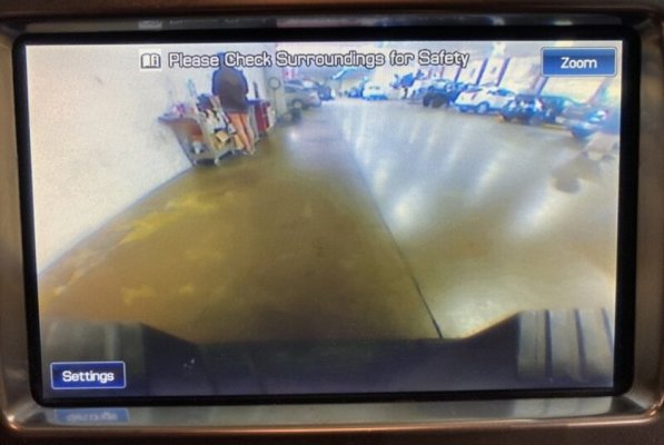

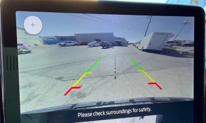

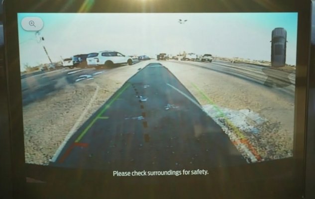

After reviewing 46 online listings of 2012 F-150 Raptors, these are the best-three Raptor photos...
