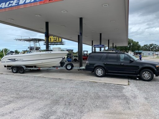

My current worn down Michelin’s are P tires, they ride great and are very quiet. Haven’t had any issue with them towing the boat. However winter is coming and tread is thin. The new Bridgestone tires I ordered are LT tires. It seemed there were more LT options than passenger rated.

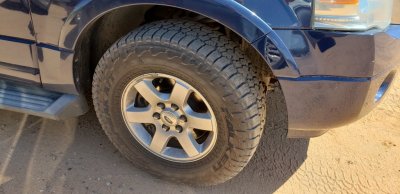

More than once have had people stop and gawk at my Wildpeaks and make favorable comments. They also work well on my 2003 Expy.
