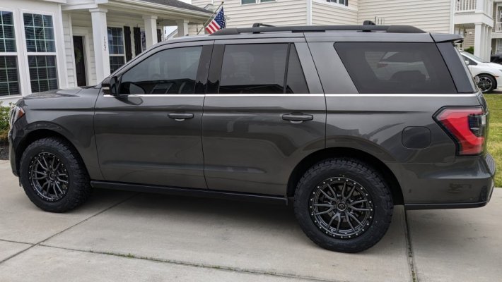

I have a (new to me) 2019 XLT Expo.. anyone with one know what the biggest A/T tire I can fit without rubbing (and possibly a pic)? I’m not putting a leveling or lift kit on, just keeping stock and changing tires/rims. The tires I’m looking at the Toyo Open Country ATIII’s in 285/70/17.

You buying new wheels or to you have 17" already? I thought the options were 18", 20" and 22". My 2017 tires are 275/65-18 and the 17" tires you suggest are only 0.5" (10mm) wider and only 0.3" larger radius. And barely makes any difference if they're 18" tires.
Put your numbers in here and compare.

275/60R20 light truck tires on stock 20” wheels. No problems (that’s a 33” wheel, stock width).

My 2019 Platinum has 285/45R22 Michelin Defenders on the stock 22" standard rims. I love the look of a bigger wheel, since my Excursion has 22" wheels.
