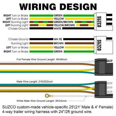

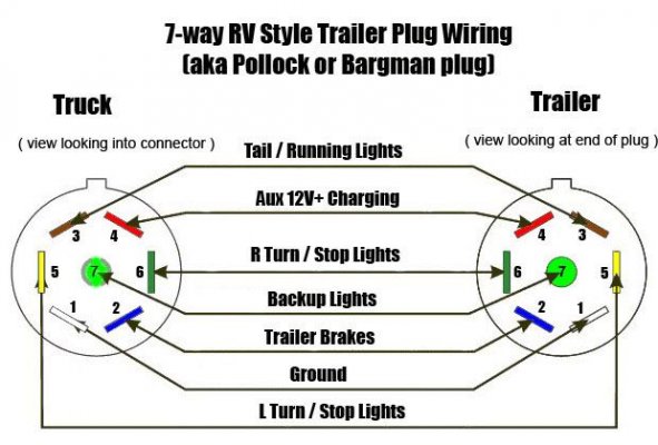

No you can't use your 4 pin flat for power since there is no power wire. You could tap your running light wire on the 4 pin but then you would always have to have your running lights on. Best bet is to follow your 7 pin plug 12V aux which should be red and tap it on the trailer side. Probably goes to your electric trailer brake battery or internal lights if you have them. You could use a 4 pin flat as a connector though after you tap it that way the camera is detachable if you wanna use it on multiple trailers. I attached your typical RV 7 pin and flat 4. Be advised 7 pins have different color schemes sometimes on older trailers. They are mostly all the same now but a multi meter never hurts with an extra hand.
My aux power currently goes to the breakaway battery, which would be pretty easy to access / connect to. The reason I mentioned the 4 pin was I was thinking of using that with the running light pins as you referenced, I do realize that I would need to keep them switched on to power the camera - not a bad thing.
