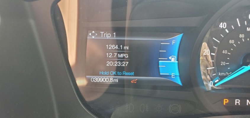

Last week made the trip back from FL to NY with the 2017 Expy pulling 20’ open trailer and car. 70 to 75 most of the trip (as conditions allowed). Decent mileage - see below, weights as follows, which shows that I need to add a weight distribution hitch, which make / model do you guys like best?

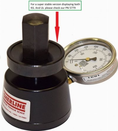

If you only need the hitch for one car, the setup shouldn't be an issue. Once you have it dialed it in works great. Just need to know the loaded trailer weight and tongue weight. A tongue scale is useful for tongue weight. Adjustment can vary based on how much weight you need to move. For minor adjustments you just need to adjust the frame bracket height, which takes like 10 to 15 minutes. For major adjustments, the head would would need adjustment, which is a much more involved process but is unlikely to be needed frequently.

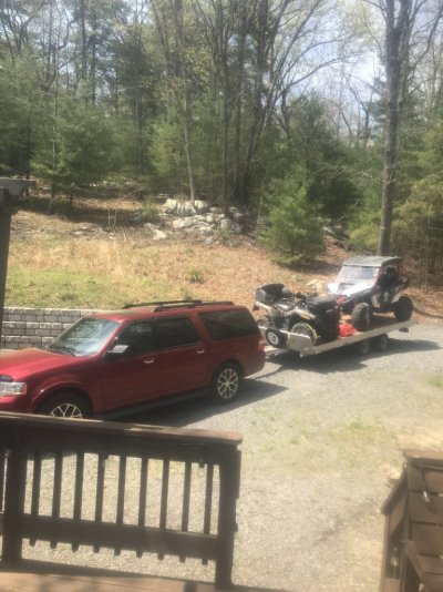

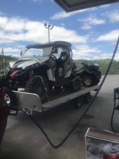

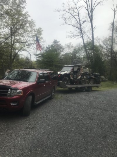

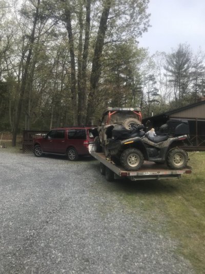

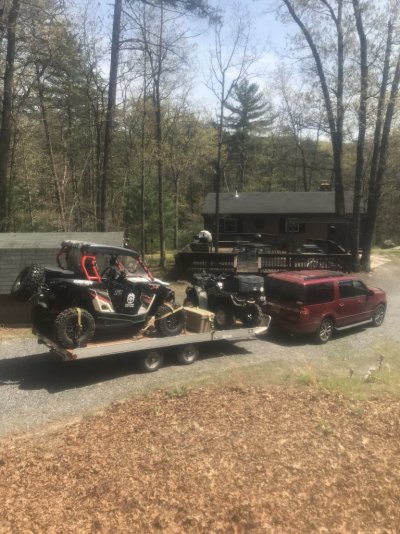

Wow your mileage was way better than mine. I hauled a Side x Side and ATV along with a 14 gallon gas can, Yeti style cooler that was completely filled on my flat bed 17’ ATV trailer. My rear cargo area was also packed full with everything but the kitchen sink. I towed from MD to southern WV very close to Kentucky of course through the Appalachian Mts. though. Mine is a 17 EL with 3.73 diff. I did push it from 75- 80 mph most of the way. My round trip was 928 miles and my average mpg was 9.4 running all 93 octane except for one tank of 87 because super wasn’t available.48710E23-51AE-4DBC-AAC5-472353ED8A50.jpeg8F9F579F-EC1B-4491-B6EF-2C8ED12EBAA0.jpeg499B85DD-9742-4B34-9ADA-748E29E6FFA6.jpegIt pulled the hills like a runaway locomotive and trans temp never went over 208 degrees on the long pulls. I did have to reposition everything on the trailer right after I left because I had a sway. Not enough tongue weight with the buggy on the back. It towed like a dream on the front though.7D2DE610-C1D6-40CD-A9D7-3DDBA5A9ABDC.jpeg6F8E939F-43EC-4AF4-85A9-81D6DBE1BC4F.jpeg
