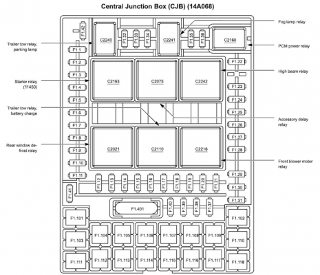

The info above is very informative, regarding park assist. Does the same info, especially turning park assist off, apply to a 2006 Eddie Bauer model? My park assist has not worked for over a year. I was thinking the issue was with one of the four rear bumper sensors. Where would the parking assist module be located? Is there a fuse for the park assist system? Input is appreciated.

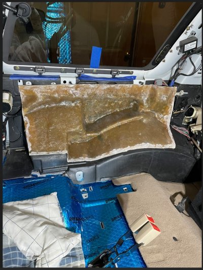

The Parking Aid Module(PAM) is located on the driver side C pillar and looks like the pic below. I included 2 pics of my custom subwoofer enclosure since they included the PAM. I think you can get to the speaker module through the cupholder at least enough to check the connector and that just snaps in.
I suspect the 2006 is the same, on my 2004 the fuse is F1.27 right side of Central Junction Box behind the passenger side kick panel. It protects the Parking Aid Module, Electronic Compass, Air Suspension Module, Overdrive cancel switch and brake shift interlock. So it's not the fuse if those other things are working.
