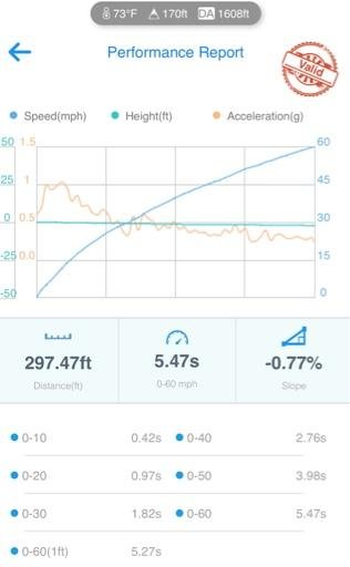

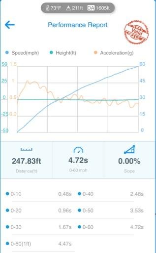

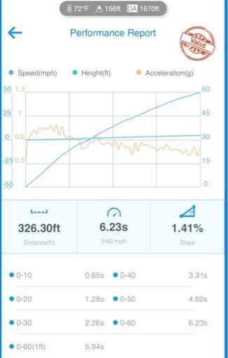

Somebody asked for it.
I have tested 3 tuners on the New Expedition and I ended up back where I always do...ZFG Racing! Adam@ZFG is a Wizard at tuning EcoBoosts. Especially when Ethanol is involved!
I used a Dragy(Very accurate GPS unit built for measuring Straighline runs) for all of my 0-60 runs.
All of these numbers were done on my 2020 Expedition Limited Special Edition Max 4x4 on 22’s. Other than an AFE Dry drop in filter everything else is stock.
Stock on 93(E10): 6.23
ZFG 93 Tune: 5.47
ZFH E85(More on that in a sec): 4.72

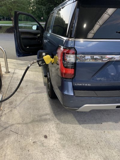

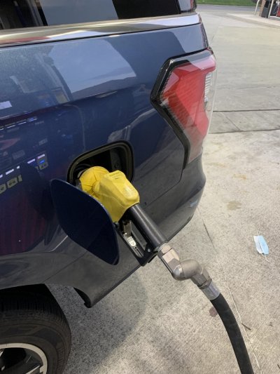

Yes, You saw that correctly. The last time was done with full E85 without an upgraded Pump. Basically the Power of E50 without mixing. Makes it much easier to fill up. Just pull up to the Pump and put the orange handle in and pump. Makes it SO much easier for the wife.
For those that say, no way, here you go:
0ecbaff47d0838685b16c0cc16bf656b.jpg3ebaea01ef17a43d7ffbd0054ef64494.jpge604cd8b5d2c5c564e32a31e126dd999.jpg432b0ac8fbb40caf8fb72eccf88b4da9.jpg
SO Much fun in this big thing. Pulls like a freight train!

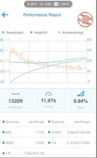

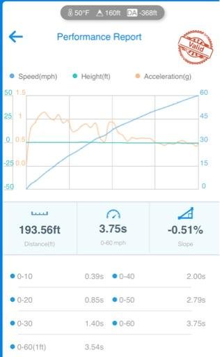

Here is my E50 0-60 on my Explorer:
Here is my 93 0-60 on my Explorer:
