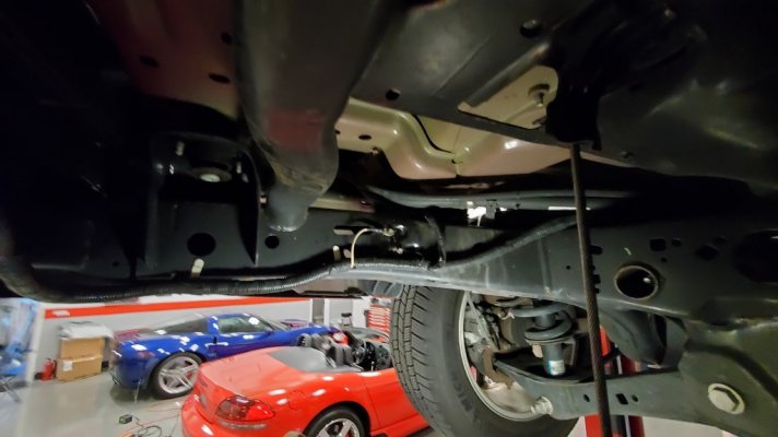

Armed with the info that the problem was somewhere in my truck, I put it up on the lift, dropped the spare tire and inspected every inch of the trailer wiring harness from the 7 pin connector to the engine bay.
The 7 and 4 pin connectors and wiring to same looked fine, as did the long harness, which runs almost the length of the truck, much of which is exposed and could be damaged by weather and / or road debris.

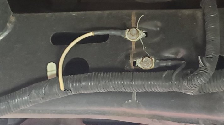

The white ground wire from the 7 pin connector runs around the spare tire / tire well and is terminated to the inside of the frame on the drivers side of the vehicle alongside the spare tire.
I found the connector to be tight but slightly corroded. I removed the connector and found the point it attached to the frame to be painted and slightly corroded.
I wire brushed the frame to remove paint and corrosion as well as the bolt and ground connector and reassembled with some dielectric grease.
Reinstalled the spare and connected the trailer and it now works fine.
So before those of you that encounter this issue go crazy cleaning and tightening 20 ground connections on your trailer, or going to the dealer for firmware updates, do the above first.20220922_134553.jpg20220922_142530.jpg
