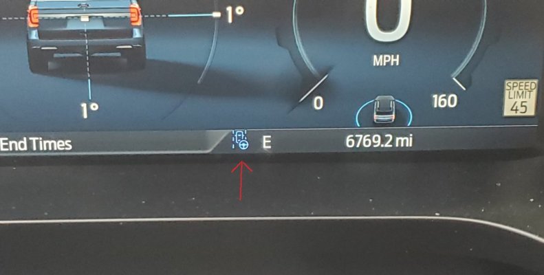

What does this icon mean (2023 Expy) ?
Sometimes it just shows up.
When it shows up on it's own it does not go on/off with the lane keeping button on the steering wheel.
What is it trying to tell me?
Is it a bug?

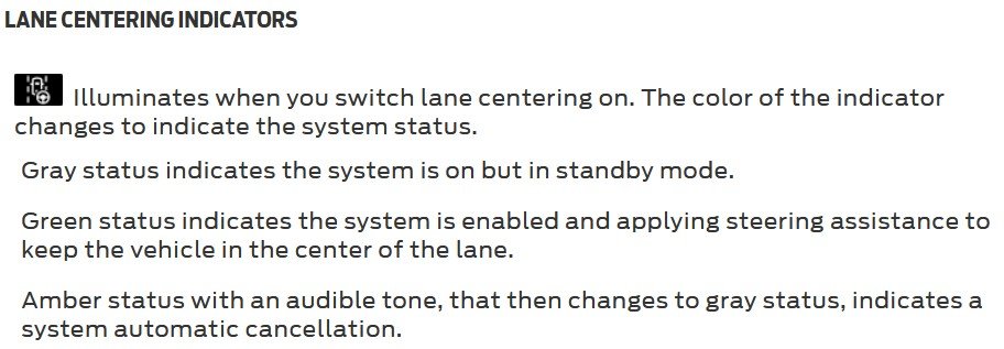

That is the BlueCruise indicator.
Read your vehicle owner’s manual for specific information regarding the system.

But you are right, that is the meaning of the icon in the manual. Next time I am in the car I will check the cruise settings. Thanks.

It very odd. The blue icon (with the arrow pointing at it) was on again today. When I turned lane keeping on and off the blue circle to the right went on and off. No effect on the icon in question.
I tried turning cruise on and off. No effect.
Then I started driving. I turned cruise control on and off. Changed the follow distance. Turned the lane keeping on and off. Nothing changed this icon. Cruise control did not try to keep me in my lane.
I feel like this is just a bug of some sort. Meh.
