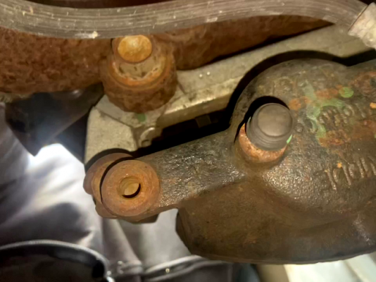

Hi All,
Looking for someone with past experience brake job with Gen 3 Expy? Should the rotors be able to be resurfaced less than 60k?
