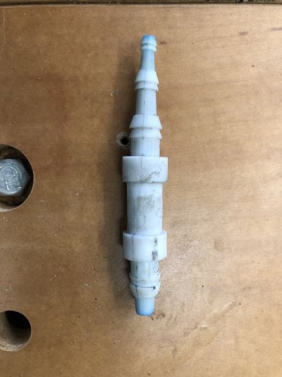

Can anyone tell me the name of this item. It is found in the washer fluid hose below the windshield washer reservoir. 1999 Expedition, XLT, 2WD, 4.6L engine. Is it available anywhere ? I have super glued this one twice allreadyIMG_2638.JPG

You could go to a Ford or Lincoln dealer with your VIN and have them look up the part - and order it if it is not in stock.

Multi hose size check valve. So fluid only flows one way. Keeps the line filled. You can pick one up at Advance Auto if you have one in your area. Or Amazon.
