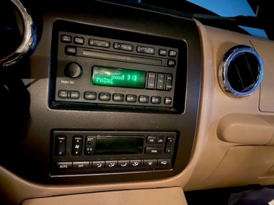

need help on what is causing the radio not to work and PHONE to be lit up. this model the phone button only mutes the radio for a call. You can not connect your phone to it. When you shut it off and remove key exit the truck it stays on. which in turn is draining the battery
A suggestion: Have you tried to disconnect the battery negative cable for a several minutes, then reconnect it - and see if the radio resets?
Has the radio worked fine, then this issue recently started?

Radio has worked fine up until about a week ago. i have not tried to disconnect and reconnect but will when i get home tonight.

I've never seen the "phone" symbol on my 03 EB. Have you looked through all the settings to see if there is a way to toggle the feature off?

you are correct. After trying to see if anyone has had the same issue and could not find anything. i Decided to unplug the radio. No sure how the radio went bad but that did the trick
light is off and battery does not drain.
Daughter is happy she got in tunes out of it. lol

I think that phone button is also on the steering wheel so a short in the switch or clockspring might cause it to stick on.
