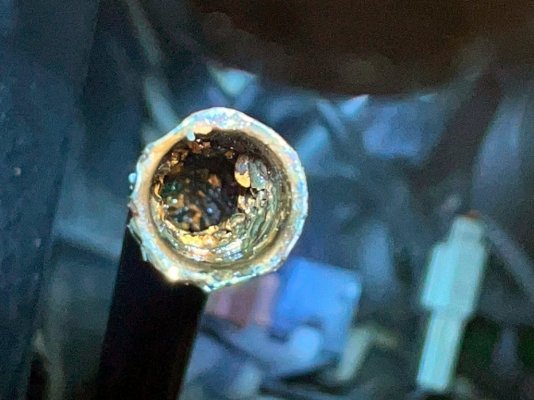

My current Expedition is no different in that respect. However, the cooling system on the 5.4L is a bit more complex. Beneath the intake manifold is a steel coolant-return tube that runs between a small "spigot" at the back of the water pump to an outlet to the rear, and just above the rear passenger-side cylinder head. This tube runs along the bottom of the valley between the cylinders, and is only accessible by the removal of the intake manifold.
Again, the tube is made of steel and is sealed to the water pump spout with 2 O-rings. Although my tube looked great from the outside, there was no telling what it looked like on the inside, how much rust was forming within it, and what kind of shape those 2 O-rings were in. Since I want my cooling system to be 100%, I decided to address this tube, along with every other hose on the truck.

--DO! inspect the steel heater tube. Mine looked GREAT from the outside, and did not leak. However, there was a lot of rust and scale on the inside, and I could easily bend it. The new tube was quite stiff, and coated with a protective layer on both the inside and the outside of the tube.

These are of the busted-up restrictor I found inside of the heater hose, the inside of the steel coolant tube, and the outside of that very same tube. Note that it looks great on the outside (except where the paint flaked off during removal), but on the inside its a total mess. I also show the difference in intake manifold bolts between the Dorman plastic intake and the stock aluminum one.
