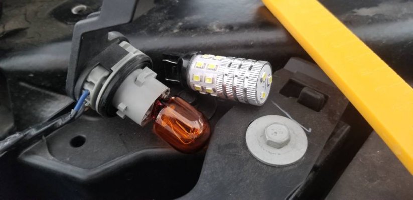

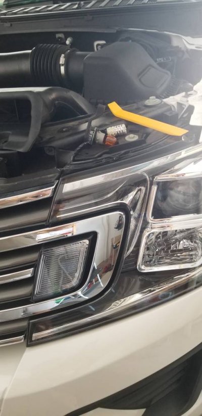

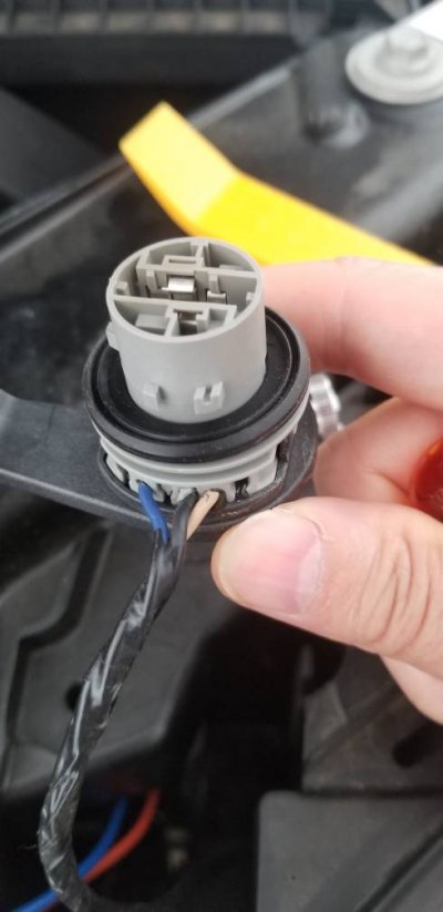

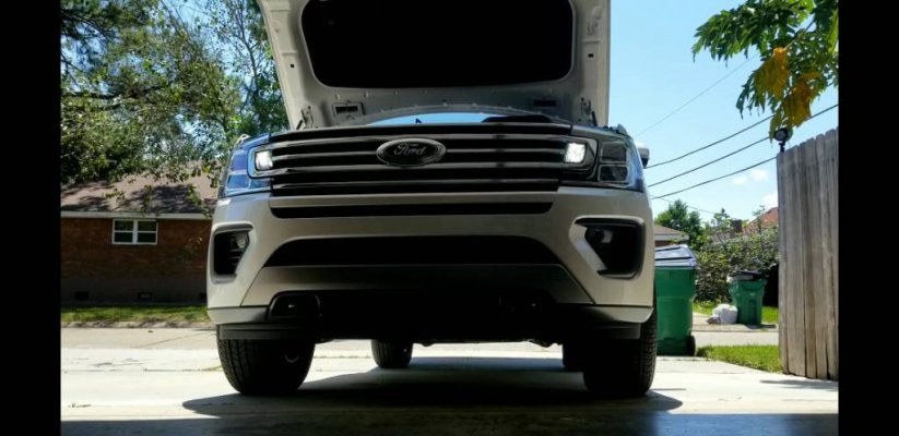

I'm successful install a VLED switchback 7443 stay lid as white as DRL and also blinks in white for now. With the forscan disable outage stated previously. Original bulb is 7444NA two filaments. You need to take the top cover out with a help of tiny hand and a pry or a stick to help out the bulb back into the headlight. I took me almost 1hr to do it myself, had to pull it out the garage to test DRL is functioning and signal by recording the video to reference that it's working, I had some loose pins in the bulbs so it did took a while.
The BAD news!
I lost my yellow pry tool at the end. Lmao...
