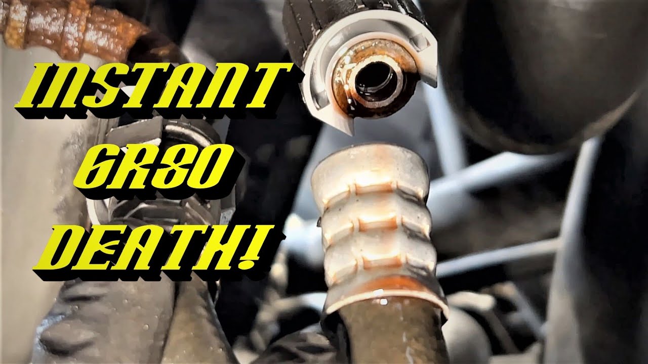

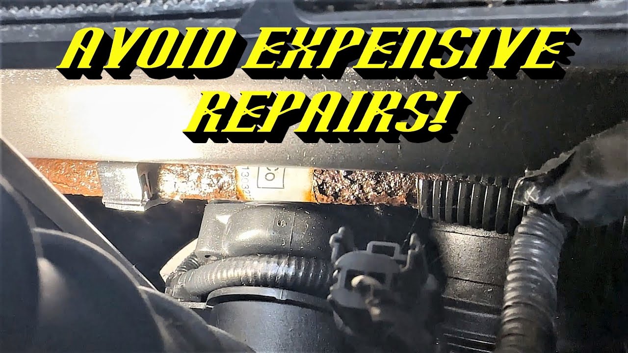

FordTechMakuloco just posted another warning about the 6R80 cooler lines, which can break/rust and cause the trans to fail.
Here's his previous warning:

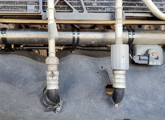

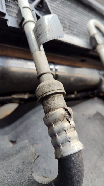

Well I was changing the oil today and just happened to check out my transmission cooler lines since I was down there. Wow!!! How this didn't come off (and take the transmission with it), I have no idea!
Check those lines everyone!!

Does anyone have suggestions on how to repair this, short of a OEM replacement of the entire assembly? I am thinking that critical junction, high pressure oil tubing and clamps. TIA
mr_dave
mr_dave
Aug 5, 2021
283
205
MN
I'm sure you could rig up something with some clamps and hose, but the "proper OEM" repair is to replace the entire hard line back to the transmission. I have mine jury-rigged with 5-6 stainless clamps for the time being, until I get around to replacing it.

It can easily be repaired with hose and clamps. That's how the world does it. I put a little flare on the metal tube where I connect the hose to help secure it. As Mr. Dave says, the proper way is to replace the lines.
