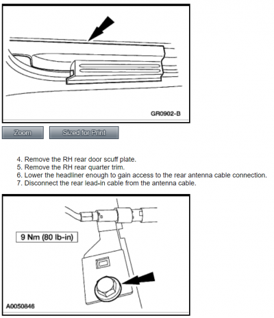

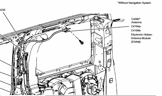

Yours being a 2015 it may not be similar to my 2004, but maybe. The window mounted antennas are at best not very good. The best reception of all the vehicles in my family is the 2000 Ranger, it has a real antenna.
Anyway, the antenna in my 2004 Expedition runs down the passenger side under the scuff plate trim and then up the C pillar. The antenna is also 2 pieces.
