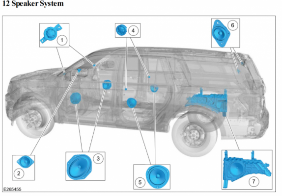

Does anyone have an accurate speaker inventory for this thing? the diagram I have which I'll post below shows speaker 2 is the center channel, but why would I hear a low frequency sub sound during testing if speaker 2 is the center channel?
Anyone know what speakers are 8 and 9?

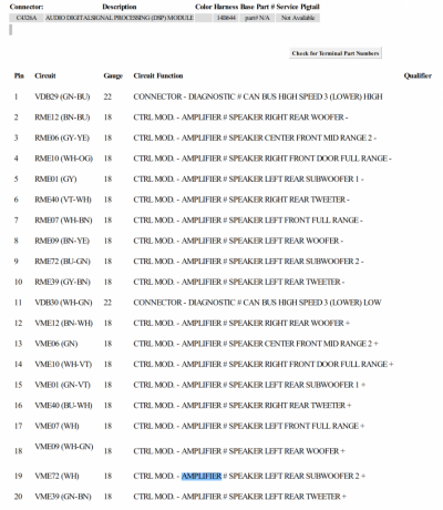

Hey all - I'm going to answer my own post, in the hopes that it helps others.
First I need to correct one of my above statements, the B&O amp side harness for the sub high level input wasn't from SGS. My guess is theirs would have worked just fine. I had originally wanted to buy one from them but they never answered a couple questions I sent them in Jan 2023, so I think I went elsewhere. Turns out the harness was from a "PlugNPlayKits". Still looks pretty legit but oh well.
So given that I had 3 speakers showing errors in the DSP test procedure, and running the integrated test sounds I had the same outcome, I had a sneaking suspicion it was the harness. Finally got some time to tear apart the rear again, pulled everything out, down to pulling out the amp and removing the harness. At that point, I reconnected the battery and started testing, and sure enough all speakers started working (minus the sub obviously). I ended up cutting the old stock harness off the sub enclosure and used that as pigtails for my sub high level input and bam, that's working too.
Ran the DSP tests and the built in sounds tests and everything was good. Bundled it all back up and finally, i have the 3D park aid sounds back and everything. From my investigation it looks as though the pinout on my 2019 is different from the harness I bought. Just in case anyone wants to see what it is supposed to be:
Subwoofer 1 - positive - coming from amplifier is pin 15 (Green with Violet trace)
Subwoofer 1 - negative - coming from amplifier is pin 5 (Grey)
Subwoofer 2 - positive - coming from amplifier is pin 19 (white)
Subwoofer 2 - negative - coming from amplifier is pin 9 (Blue with Green trace)
Removing the harness and tapping those wires returned all audio functions and my DSP tests all complete fine. Sub still seems to work fine, I had to adjust levels a bit but what's more important is the vehicle functions are okay.
This is what I saw for the connector coming off the amplifier:
So my issues were my issues but glad it's working now.
