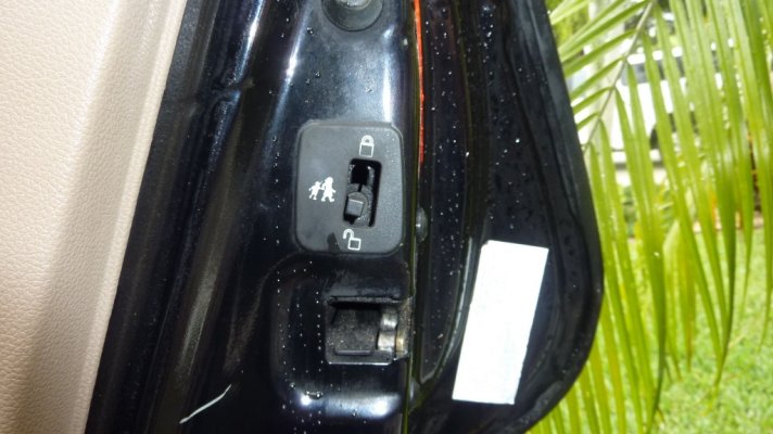

Do you hear the door lock cycling on that door when you hit the key FOB ? Do you have the child lock protection engaged? The child lock switch should be down to allow regular lock/unlock cycling. If the door is closed, it's just on the outside of the weatherstrip above the latch.
