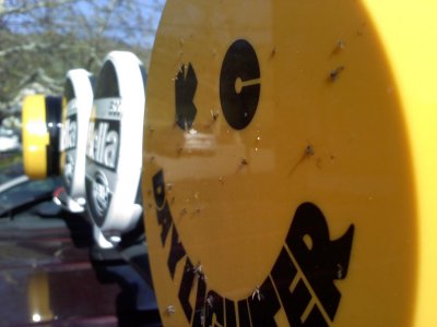

Finally used one of these for the first time, and wow what a difference! Well, at least until all the rain cropped up this week.
Only downside, it must have taken me 4 hours to do it! Not bad for 12 year old factory paint.
