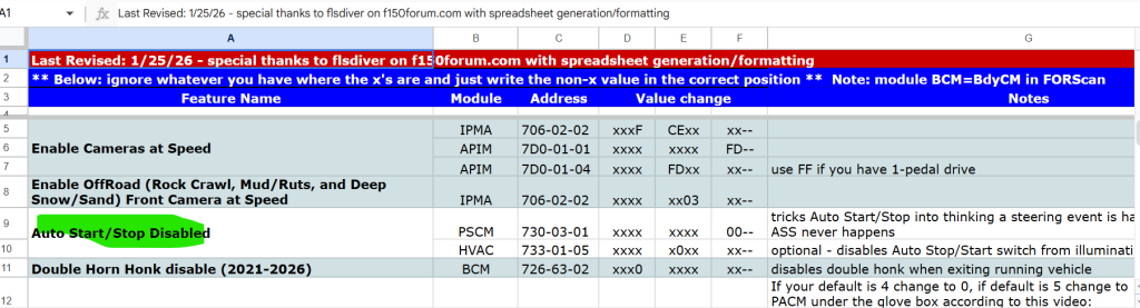

so, on my 2019 Limited Stealth, I took a stab at disabling Auto Start/Stop with Forscan, but it triggers a error at startup about 'Check Charging System Soon' or something. meh.
First, I tried following someone elses howto that had me putting hex codes into various 'AS BUILT' things, but my IPC codes didn't match his, so I backed out what I'd changed on the BdyCM and FCIM. Then I just went into the BdyCM (not AS BUILT) and instead of hex codes, its a simple 'AutoStart/Stop disable' and it seemed to work, but throws the Check Charging error every startup. No DTC's in any modules.
