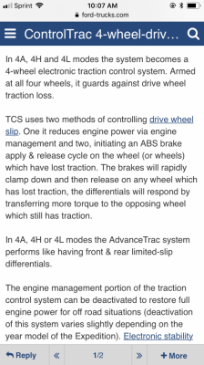

Notice they subtracted AdvanceTrac though, then they can put the LSD. Here is a thread that explains the Expeditions 4WD system perfectly on FTE. Control Trac Coupled with our AdvanceTrac traction management when engaged in 4WD is basically like having front and rear LSD, it mimics it through the computer and becomes a 4WD assist system when you engage the 4WD. The Expedition gets a very good rap from this system because our trucks will go through what many of the competitions struggle with because of the 4WD system and the complex software involved.
https://www.ford-trucks.com/forums/928481-controltrac-4-wheel-drive-and-how-it-works.html
