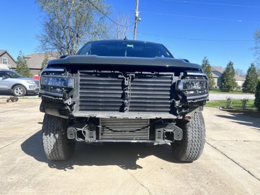

It’s actually very simple! Obviously I had to go a little further than just removing the grille. This bumper relocated the factory camera into the bumper.
