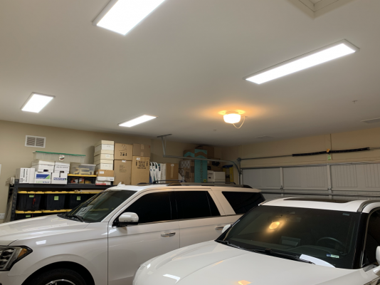

I replaced all of the fluorescent lights with LED panel lights from Home Depot. They are pricy (around $100 per) but they do an outstanding job of lighting up the whole garage(s) and hardly use any electricity. I have four in our two-car and two in our one-car. Given their cost, I replaced then in stages. In addition to the light output, they can be set for three light colors and they do not flicker when cold.
Question about the fixtures you used.
I currently have 2 4 foot 2 bulb fluorescent fixtures in my 2 car attached garage, which does not provide sufficient light.
Each bulb in each fixture is 40w putting out 3200 lumens for a total of 6400 lumens per fixture / 12800 for both Fixtures.
The fixtures you linked above are rated at 4000 lumens each, so it looks like I would need 4 fixtures to get where I want to be.
Do you know if they offer a higher output version of this fixture?
