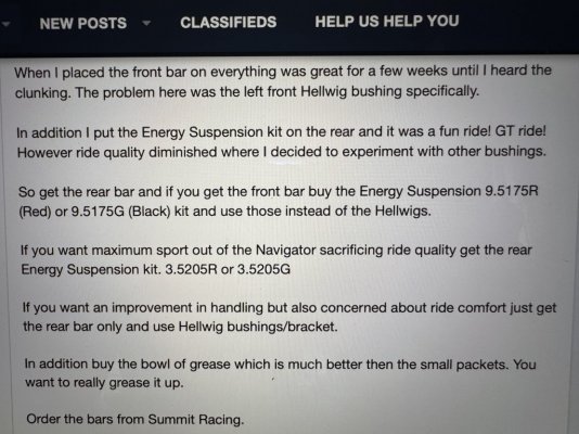

Experienced a similar situation after 6 months of driving my 2019 4x4 Limited Stealth with both the front and rear Hellwig sway bars installed. Replaced the front bushings with Energy Suspension Polyurethane 1-7/16 #9.5175G. Has serviceable grease fittings. No more clunk after first test drive.

Experienced a similar situation after 6 months of driving my 2019 Limited Stealth with both the front and rear Hellwig sway bars installed. Replaced the front bushings with Energy Suspension Polyurethane 1-7/16 #9.5175G. Has serviceable grease fittings. No more clunk after first test drive.
View attachment 72593View attachment 72594
The bracket appears to be a better fit than the Prothane model that I got.
I think this is that largest Energy Suspension greaseable model that is made.

Great bushing finds guys! Mine are squeaking and the fronts are banging. I ordered a set of the Energy Suspension bushings to hopefully help! I hate the noise, but I absolutely refused to take the Hellwig bars off, because I can't imaging driving that factory bobble-head sway boat ever again. My wife even said, I'll take that banging noise over driving the swaying titanic! lol
Again, thanks for the bushing info! :)

I received replacement bushings from Hellwig last week for the front due to the clunking noise. The clunk is gone now. I did notice that the rubber on the new bushing seems stiffer than the original Hellwig bushing.

I managed to put the Energy suspension units on today, and a couple things I noticed. Both of the zerks were cross-threaded. Managed to get them to work by pulling them out and cranking them back in. I also noticed that I think these bushings are probably 1/8 to 3/16 inches too small of inner diameter. At least for me, when put around the bar, the insertion gap in the slot was at least 1/8". This of course closed when I cranked them down a lot but I'm concerned that this much resistance may actually cause them to wear down faster than they should.
we'll see if they are any better, but hope so.
