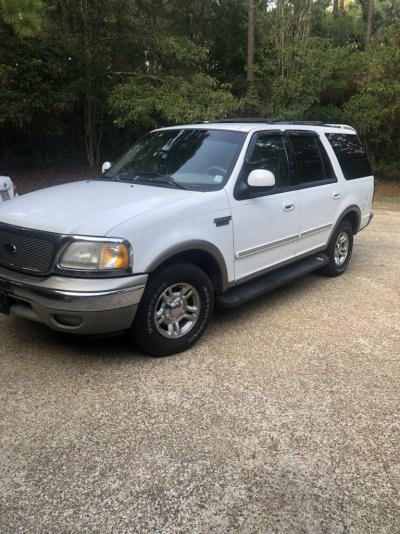

I At least got my center caps on.. I got the cheap ones.. You have to adjust the prongs a little to make the fit easier..
