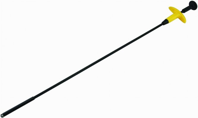

Get your bore camera and one of these lighted grabbers anything else that is to small for the grabber you can blow out with a compressed air nozzle.
https://www.amazon.com/General-Tool...ds=telescoping+grabber&qid=1614771496&sr=8-39

Thanks. I tried with small grabbers, but its head was too long (and not flexible) to move through the spark plug hole while the piston position is quite high.
