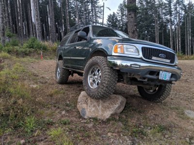

You can get 35" tires with just torsion keys and spacers. I stuffed 37's with a little trimming.
