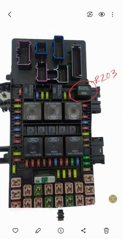

Try wiggling or pulling the PCM relay (R203) and reinserting it . You can also swap it with one of the other similar relays in the same row as it. They are all the same. This was my culprit with the same exact issue you have for a long time. It went from every once in a while to every time I needed to start it after a year or so of finding this problem. After I replaced the fuse box it went away completely.
