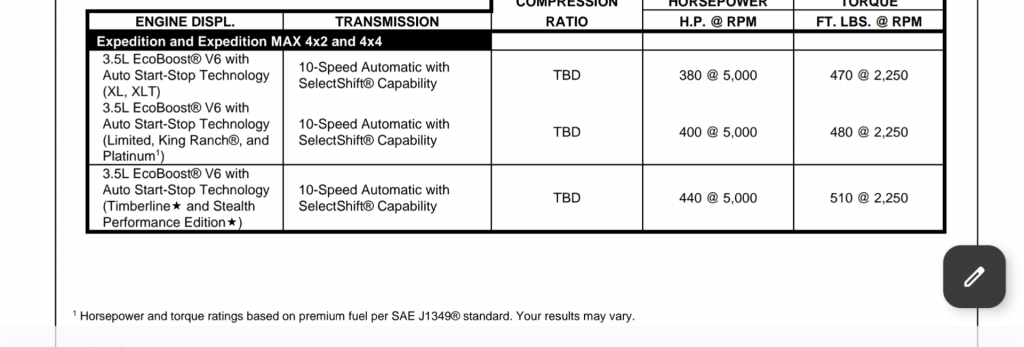

The 400HP and 440HP version of this engine certainly does not put out the full rated HP when running on 87 fuel, that is alluded to in this statement from above.
I dint know how much the engine puts out with one or the other, but I do not see that as alluding that it puts out less power with regular fuel. Ford recommends regular and they rate a platinum at 400 Hp. To me that says it puts out rated power with recommended fuel.
What they say is that the engine runs better in hot weather and heavy loads with premium. Hot weather in particular causes power to go down all else being equal. Simple physics, less oxygen.
I think It’s more likely that on premium it does not lose power under certain circumstances because the engine will not pull boost to keep it from detonating under more severe conditions.
My main reason for believing the 400 is on regular fuel is simply that is the recommended fuel. Some companies, like Geneses and Mazda tell you that premium is the recommended fuel but you can safely on lower octane but it will reduce power, and some even tell you what the lower power will be.

The 375hp, or 400hp, or 440hp, depending on your trim and engine is with 91+ octane fuel (the actual SAE I believe nets out around 92 octane)
All tests and HP/TQ ratings are with the higher octane.
You can safely run the 3.5TT down to 87 octane with no issues, the engine will dial back the timing automatically. HP, Torque, and fuel economy are reduced by roughly 10%.
Keep in mind, timing reductions are not consistent for the entire power band, it is most noticeable in higher RPM scenarios or when engine load is high.

What they say, exactly from the current owners manual, is below. They say it'll operate at regular, but recommend premium.
Your vehicle operates on regular unleaded gasoline with a minimum pump (R+M)/2 octane rating of 87.
For best overall vehicle and engine performance, premium fuel with an octane rating of 91 or higher is recommended. The performance gained by using premium fuel is most noticeable in hot weather as well as other conditions, for example when towing a trailer. See Towing a Trailer.
We recommend Top Tier detergent gasolines, where available to help minimize engine deposits and maintain optimal vehicle and engine performance.

I understand what mine is rated at. That’s not what I was saying. Sorry for confusion. How do you know it’s rated at higher octane. Normal practice is to rate at recommended fuel. That is 87 octane on the expedition.
