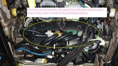

looking at the options, I am thinking either a wiring issue, the button module or the seat computer is faulty, given these facts:
1- the seat backs up when I take out the key (forward/backward works)
2- The memory functions were working until I pulled the seat fuse.
Also, the wire loom between the seat control module and the seat computer is a bit worn, but not worn through the plastic, so I don't think the wires are frayed.
