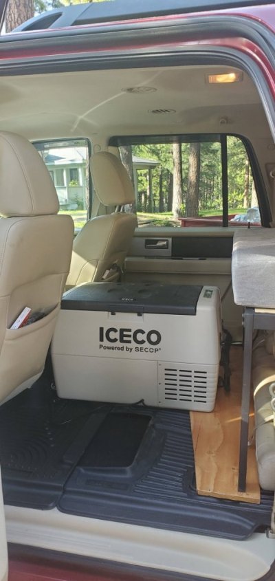

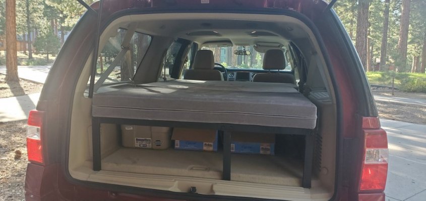

I took out the 2nd & 3rd rows. DIY wooden platform. Cut so I can optionally reinstall one or both of the outside 2nd row seats. Walmart queen size mattress toppers, trimmed to fit wheel wells. Queen size sheets. This rig sleeps two comfortably on multiple weeks long trips.20230515_100013.jpg20230515_100028.jpg

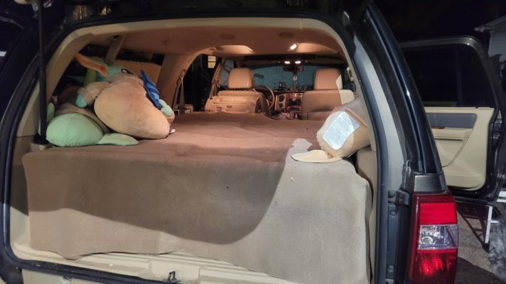

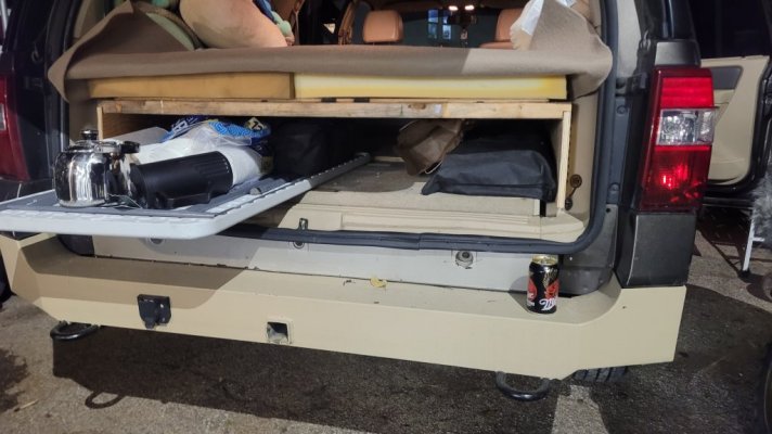

Not exactly a sleeping platform, but it folds pretty close to the same height as the second row, so I can lay down and nap if I stick my feet through the middle seat, and I don't even have to take out the kids car seats.
It would be super easy to add a battery box underneath where the third row folded into, and the switches for the seats take a standard Carling style switch, so you can add switched circuits off a house battery without too much work, just putting in an on-off-on switch in the hole the seat switches left. I bought some switches, a fuse panel, battery isolator, and an AGM battery, but haven't wired them up. I managed to have a second kid after I built this and, well, I just have had other priorities since then.

Nice, looks like a lot of space with bunches of headroom. Did you only go to the level of the rear where the flip-up door hides the jack and tools? Did that stop you from installing drawers or was that all the space you needed? Looks like a great space for batteries, solar controller, inverter, etc. as well as a loadout for a backpack. Thanks for the picks.
