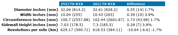

I have a 2010 Eddie Bauer Expedition, right now it has the stock 255/70/18's on it. I was wondering if I could run 265/70/18's on the factory wheels and not have any issues with fitment. Also will it affect the computer in the vehicle at all ? Thanks for any info.

Thanks for that info, the calculator is a big help. It looks like it would be even better if I was to run a 275/65/18.

do you have a link to the caculator? he'll actually be going a little faster

freeway click were it says tire size calculator. thats the link

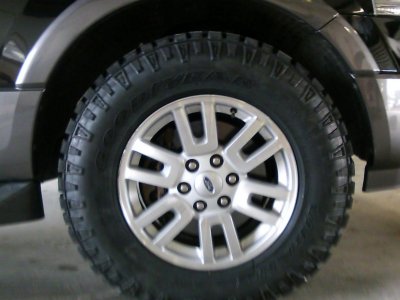

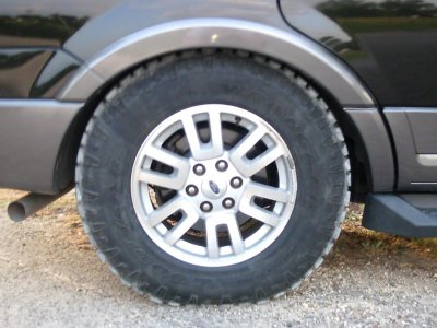

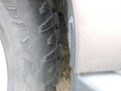

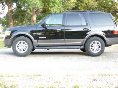

I will be able to answer that question in a few days. I ordered a set of 275/70/18 Goodyear Wrangler Duratracs for my completely stock 07 Expedition 4x4. They are only 1.1" taller and 0.7" wider than stock, so I am not worried about them rubbing. I guess I will look pretty stupid if I am wrong! We shall see.
