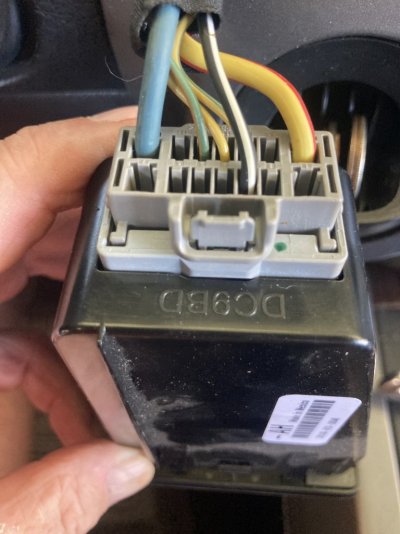

Gary, the new controller showed up today but didn't look like I thought it should so I pulled the radio fascia off and popped the controller out of the dash. The part I received was totally different then what is installed in the expy so back it goes. In the meantime this is the plug on the controller with six wires. I'm assuming the larger gauge blue wire is the wire that goes to the trailer to activate the brakes but the remaining wires are a mystery. Seems like if I disconnect the plug and apply the VOM to the contact that matches the blue wire it should not be hot if the brakes aren't applied and if it is hot then the controller is faulty, any thoughts

I suspect you need someone with a more modern expedition. Mine is an 08 and only has 4 wires (but it’s an aftermarket controller, I don‘t think ford offered factory controllers back then).
my guess is that the 2 large wires (yellow and blue) are the main 12volts in and the trailer brake wire out. That leaves the 4 smaller wires, one must be the brake pedal switch, another must be ground, but I have no idea what the other 2 are, 1 is probably connected to the lights so your controller facade lights up when the headlights are turned on, and no idea about the last wire..
hopefully someone with knowledge of the later controllers can help out.
You should still check that one of the large wires (yellow and blue) is live all the time (has 12 volts present) and that the other wire just goes to the 7 pin trailer plug and does not have any connection to positive or ground (again with no trailer connected) to make sure you haven’t got a wiring failure.

Thanks Gary, you've been a great help, I agree the smaller gauge wires must be lighting or perhaps solenoid controls as they are too light a gauge to be carrying much load. I'll check the two larger wires and see where that leads me.
