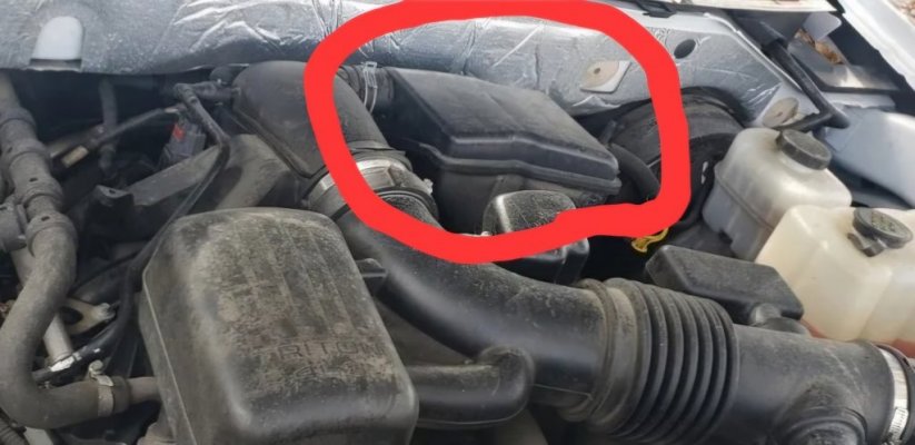

What is this box on my air intake for?

2013 ford expedition. Idk what the box on the side of my air intake is for and is it needed? I had an 07 expedition and it didn't have this, I want to take the air intake off the 07 and put it on the 13 since I paid $250 for it.

That is a resonator. It helps balance the pressure waves in the intake smoothing the flow which makes it quieter and possibly improves power. I have seen debate on if this really impacts power or is just for a quieter ride.

It's just for noise. Swap the 07 kit on and see how it sounds, if it has provisions to mount your maf meter.

I'll let you know how it goes after swapping

If you paid $250 for a "cold Air Intake" and it draws air from under the hood, you did not get a cold air intake. The factory OEM intake draws air from under the fender where it is cooler.

It draws air from the fender like the original intake, uses a larger intake tube in the fender
