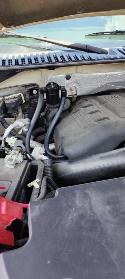

This one https://offroadalliance.com/products/jlt-oil-catch-can/ is the one I have on the passenger side. I had to massage the bracket using a bench vise and my hand to modify it for my 2017.
If you had bought the kit designed for the 15-17 Expedition, you wouldn't have had to bend anything. You bought the wrong kit. There is absolutely no advantage to buy from anywhere other than directly from JLOSC(Previously JLT). Most of the other companies that sell it do direct ship from JLOSC anyway. Also, when you order they verify your car, year, and Engine so you get the correct kit.

I get it, but hey it works and doesn't look half bad where I mounted it. Edited my reply with the correct link for the Expeditions.
Agreed. Looks good. One of the options for the 15-17 used to mount there for those that ran early kits on a 2015. Moved to the battery area mount for the current kits. No longer have to reach over the motor. It is an advantage in some ways and disadvantage in others. Still have the 2015 kit in my Garage, from where I removed it, when our 15 was totaled.

The current kit for the 15-`17 no longer mounts to the Firewall. It mounts by the battery on the front left of the Engine bay. That was discussed above.
