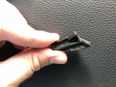

My sunroof made a loud pop while closing yesterday. I had to use the procedure in the manual to get it to close again after I had opened it. I found this in the track when I opened the sunshade this morning. I’ll be planning a trip to the dealer next week!CB4C9F0A-3CA9-4E48-8902-9C431451ADE8.jpeg

wakeboarder ... have you had any issues with the sunroof leaking? I had that same issue yesterday and have the exact piece in my hand right now.
Did you have it repaired or just left it as it?
