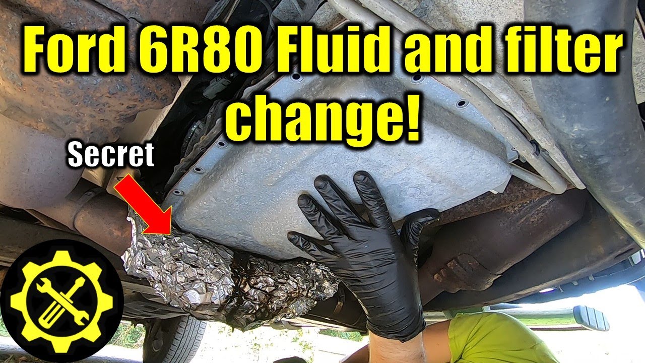

I’d change transmission fluid and filter. Pretty easy. I just did mine (new to me w/144k). Fluid was old but didn’t smell.
I also swapped out my pan for one with a drain plug. I’m going to run another 5k miles and drain and fill again.
There’s videos on how to do it. Running aluminum foil over the back keeps your fluid in your drain pan.
