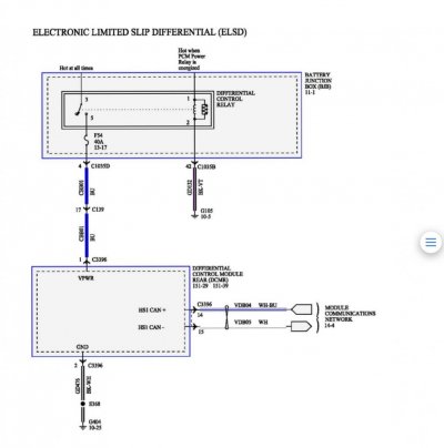

Here are the wiring schematics for the eLSD. It is power, ground and CAN. I think the second schematic is all wiring internal to the eLSD. It may be as simple as hooking up the wires and enabling eLSD and changing the axle ratio in forescan. A search for eLSD and HD tow on parts.ford.com would be good to ensure that no other electronic components have changed. You will find stuff related to the backup camera, but you should be able to ignore that since it is for the backup assist. It could also be a lot more complicated. You are in a new territory. C6ECD96B-1052-40E4-A8B2-A0D3136C3378.jpeg16BA1A14-1084-4490-B951-7ED68AEF3322.jpeg

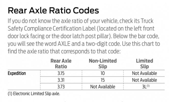

Here are the axle codes from the 2019 towing guide. I beleive the 2018’s are the same, so you would have a 3.31 non-limited slip. Is it a MAX length?C0F0C39D-82BB-4EFD-AE45-9294F9C7A8CD.jpeg
